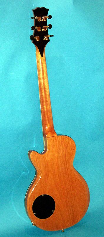

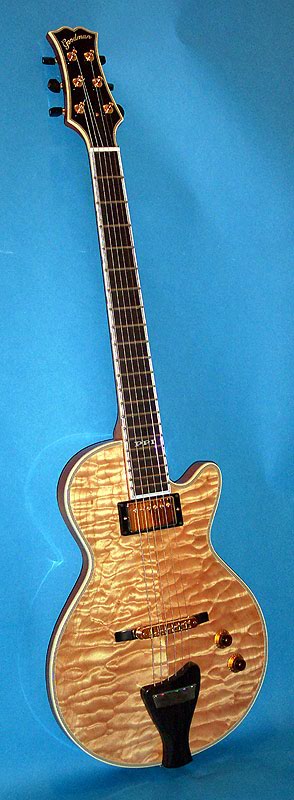

I found a picture of the electric I made.
Honduran mahogany body and neck,quilted maple carved top,ebony appointments.
It is based on a Les Paul,but I made it about a 1/2" thinner which reduced the weight dramatically.

Cool guitar Brad. Clean, pretty and elegant!
Mark
